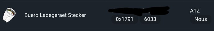

### Link
https://nous.technology/product/a1z-1.html
### Model
A1Z
### Descri…ption
Smart plug (with power monitoring)
### Vendor
Nous
### Picture (link)
https://www.zigbee2mqtt.io/images/devices/A1Z.png
### Database entry
{"id":2,"type":"Router","ieeeAddr":"0xa4c1386a23da61cd","nwkAddr":45996,"manufId":4417,"manufName":"_TZ3000_2putqrmw","powerSource":"Mains (single phase)","modelId":"TS011F","epList":[1,242],"endpoints":{"1":{"profId":260,"epId":1,"devId":266,"inClusterList":[3,4,5,6,1794,2820,57344,57345,0],"outClusterList":[25,10],"clusters":{"genBasic":{"attributes":{"65503":"�j�0\u0003","65506":54,"65508":0,"65534":0,"modelId":"TS011F","manufacturerName":"_TZ3000_2putqrmw","powerSource":1,"zclVersion":3,"appVersion":192,"stackVersion":0,"hwVersion":1,"dateCode":""}},"haElectricalMeasurement":{"attributes":{"acCurrentDivisor":1000,"acCurrentMultiplier":1,"rmsVoltage":231,"rmsCurrent":0,"activePower":0}},"seMetering":{"attributes":{"divisor":100,"multiplier":1,"currentSummDelivered":582}},"genOnOff":{"attributes":{"32768":0,"onOff":0,"onTime":0,"offWaitTime":0,"tuyaBacklightMode":1,"moesStartUpOnOff":0,"tuyaBacklightSwitch":1}},"manuSpecificTuya3":{"attributes":{"53248":0,"53249":0,"53250":0,"53251":0,"53252":0,"53253":0,"powerOnBehavior":0,"switchType":0}}},"binds":[{"cluster":6,"type":"endpoint","deviceIeeeAddress":"0xbc026efffe0b7589","endpointID":1},{"cluster":2820,"type":"endpoint","deviceIeeeAddress":"0xbc026efffe0b7589","endpointID":1},{"cluster":1794,"type":"endpoint","deviceIeeeAddress":"0xbc026efffe0b7589","endpointID":1}],"configuredReportings":[{"cluster":2820,"attrId":1285,"minRepIntval":5,"maxRepIntval":3600,"repChange":5},{"cluster":2820,"attrId":1288,"minRepIntval":5,"maxRepIntval":3600,"repChange":50},{"cluster":2820,"attrId":1291,"minRepIntval":5,"maxRepIntval":3600,"repChange":10},{"cluster":1794,"attrId":0,"minRepIntval":5,"maxRepIntval":3600,"repChange":257}],"meta":{}},"242":{"profId":41440,"epId":242,"devId":97,"inClusterList":[],"outClusterList":[33],"clusters":{},"binds":[],"configuredReportings":[],"meta":{}}},"appVersion":192,"stackVersion":0,"hwVersion":1,"dateCode":"","zclVersion":3,"interviewCompleted":true,"interviewState":"SUCCESSFUL","meta":{"configured":332242049},"lastSeen":1762045286297}

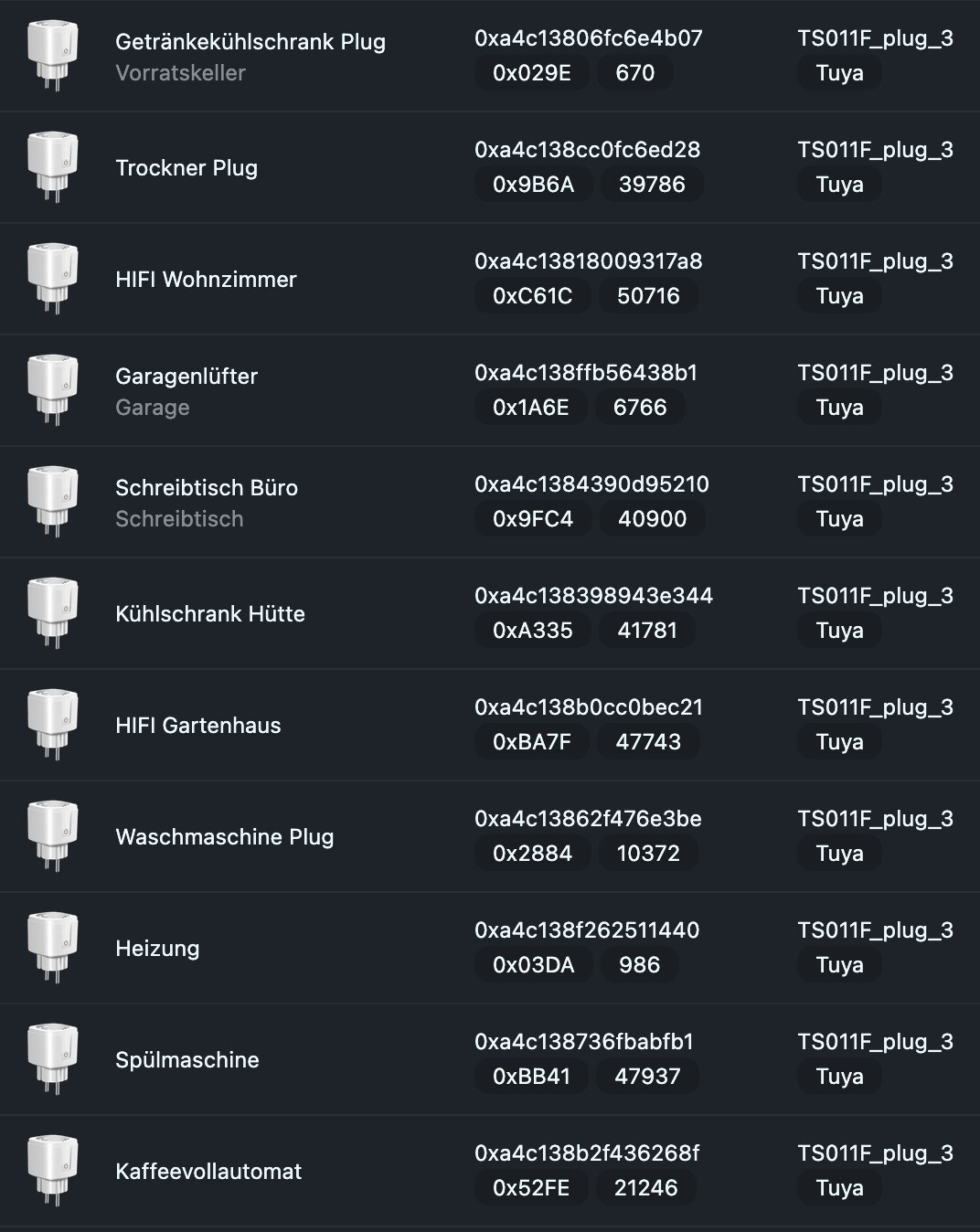

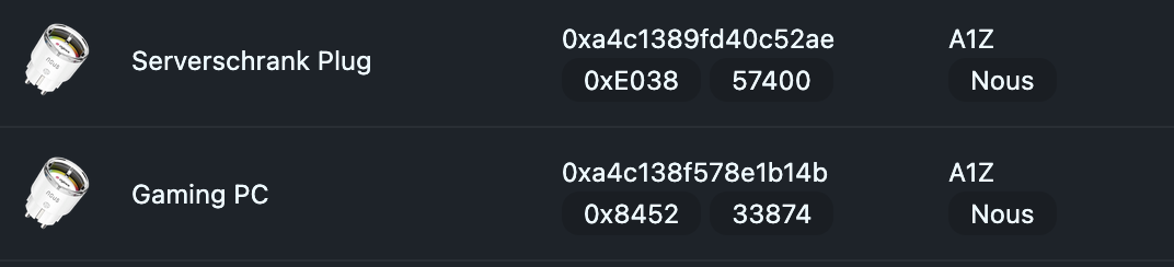

### Notes
After the update, the device data changed from Nous A1Z to Tuya TS011F_plug_3
