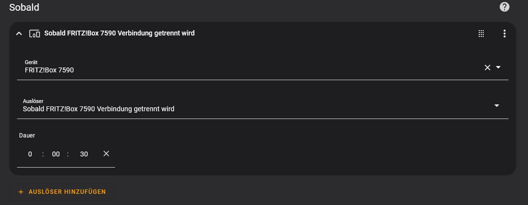

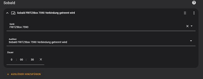

Moin, probier mal meinen Vorschlag. Hier in einer separaten Automation.
alias: Test Fritzbox Neustart
description: ""
  - type: not_connected
    device_id: 412xx18f4884d3f0963186e8c21497fc
    entity_id: d6cc2dc5b9e609437b58adcf2bb773f5
    domain: binary_sensor
    trigger: device
    for:
      hours: 0
      minutes: 0
      seconds: 30
conditions: []
  - action: notify.persistent_notification
    metadata: {}
      message: Die Fritzbox wurde neu gestartet
  - action: hassio.addon_restart
      addon: core_mosquitto
    enabled: true
mode: single
