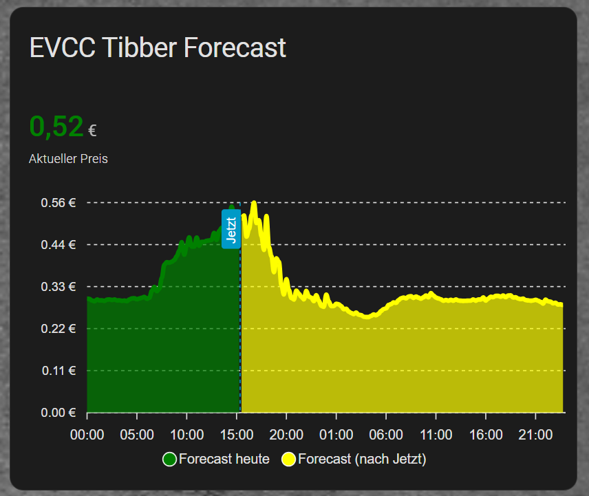

Hier eine aktualisierte Version des Apex Charts Code
type: custom:apexcharts-card
apex_config:
  chart:
    height: 268px
all_series_config:
  float_precision: 3
header:
  title: EVCC Tibber Forecast
  show: true
  standard_format: true
  show_states: true
  colorize_states: true
graph_span: 2d
span:
  start: day
now:
  show: true
  label: Jetzt
yaxis:
  - id: price
    min: 0
    apex_config:
      tickAmount: 5
      labels:
        formatter: |
          EVAL:function (val) { return (Number(val)||0).toFixed(2) + ' €'; }
  - id: header
    show: false
series:
  - entity: sensor.evcc_tariff_api_grid
    yaxis_id: price
    type: area
    color: green
    stroke_width: 4
    extend_to: false
    show:
      legend_value: false
      in_header: false
    data_generator: >
      const attrs = (entity && entity.attributes) ? entity.attributes : {};
      const rates = Array.isArray(attrs.rates) ? attrs.rates : []; const nowSec
      = Math.floor(Date.now() / 1000); const out = []; for (const r of rates) {
        if (!r) continue;
        const s = Number(r.start_utc);
        const v = Number(r.value);
        if (!Number.isFinite(s) || !Number.isFinite(v)) continue;
        if (s <= nowSec) out.push([s * 1000, v]);
      } out.sort((a,b) => a[0]-b[0]); return out;
    yaxis_id: price
    type: area
    name: Forecast (nach Jetzt)
    color: yellow
    stroke_width: 4
    extend_to: false
    show:
      legend_value: false
      in_header: false
    data_generator: >
        if (!r) continue;
        if (s > nowSec) out.push([s * 1000, v]);
  - entity: sensor.evcc_tariff_grid
    yaxis_id: header
    unit: " € "
    float_precision: 3
    color: green
    show:
      legend_value: true
      in_header: true
      in_chart: false
Ansonsten einfach nach dem Video vorgehen.
