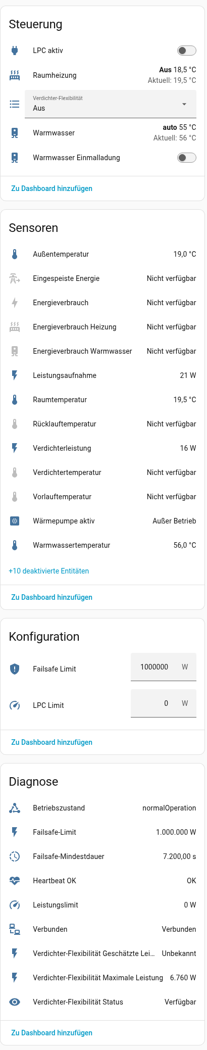

### Beschreibung
these entities are always unavailable:
Compressor Temperature,… Current L1, Current L2, Current L3, Energy Consumed, Energy Consumed Domestic Hot Water, Energy Consumed Heating, Energy Produced, Flow Temperature, Return Temperature, Grid Frequency, Power L1, Power L2, Power L3, Voltage L1, Voltage L2, Voltage L3.

"capability": "dhw_system_function",
"reason": null,
"last_changed": "2026-09-03T18:18:15.719075"
"capability": "failsafe",
"reason": null,
"last_changed": "2026-09-03T18:18:15.766861"
"capability": "heartbeat",
"reason": null,
"last_changed": "2026-09-03T18:18:23.031242"
"capability": "lpc",
"reason": null,
"last_changed": "2026-09-03T18:18:15.615799"
"capability": "monitoring",
"reason": null,
"last_changed": "2026-09-03T18:23:15.032254"
"capability": "ohpcf",
"reason": null,
"last_changed": "2026-09-03T18:18:15.507878"
"capability": "room_heating",
"reason": null,
"last_changed": "2026-09-03T18:18:15.615026"
"fresh_fields": [
"compressor_flexibility",
"compressor_power_w",
"connected",
"consumption_limit",
"device_info",
"device_operating_state",
"dhw_setpoint",
"dhw_temperature_c",
"failsafe_limit",
"heartbeat_status",
"local_ski",
"outdoor_temperature_c",
"power_watts",
"room_heating_setpoint",
"room_heating_system_function",
"room_temperature_c",
"ski_registered"
"recovery": {
"bridge_unavailable": false,
"last_successful_read_age_seconds": 134.592185,
"last_update_success": true
"streams": {
"last_device_state_revision": 14876,
"refresh_pending": false,
"refresh_running": false,
"primary": {
"configured": 1,
"running": 1,
"done": 0,
"reconnects": 0
"legacy": {
"configured": 0,
"running": 0,
"done": 0,
"reconnects": 0
"bridge_operational": {
"redacted_ski": "\u2026509542",
"readiness": "DEVICE_READINESS_READY",
"recovery": {
"state": "DEVICE_READINESS_READY",
"attempts": 0,
"first_stale_at": null,
"last_attempt_at": null,
"next_attempt_at": null,
"last_transition_at": "2026-09-03T18:18:19.486352+00:00"
"event_revision": 14876,
"dropped_events": 0,
"resync_count": 0,
"unresolved_events": 0,
"connection_age_seconds": 57365,
"monitoring_last_success_age_seconds": 2,
"snapshot_duration_milliseconds": 24,
"snapshot_last_success": "2026-09-04T10:12:06.292243+00:00",
"providers": [],
"features": [
"FEATURE_EXPLICIT_CAPABILITIES",
"FEATURE_CONSOLIDATED_DEVICE_STREAM",
"FEATURE_PROVIDER_SAMPLE_INVALIDATION",
"FEATURE_DEVICE_SNAPSHOT",
"FEATURE_TYPED_MEASUREMENTS",
"FEATURE_OPERATIONAL_DIAGNOSTICS"
"measurements": {
"unknown_typed_ids": 0,
"invalid_typed_units": 0,
"invalid_legacy_units": 0,
"extension_strings": 31
"issues": []
### Live-Watcher-Ausgabe (optional, bei Verbindungs-/Datenproblemen)
```shell
### Netzwerk-Checkliste
- [ ] Bridge laeuft mit `network_mode: host` (mDNS-Discovery braucht das, siehe `docker-compose.yml`)
- [x] HA und Bridge sind im selben Netzwerksegment (kein VLAN-Split, keine mDNS-Filterung)
- [ ] Am Gateway ist aktuell **keine andere** EEBUS-Verbindung aktiv (z. B. kein paralleler Energiemanager wie die sensoNET-Cloud -- Vaillant-Gateways erlauben nur eine)
