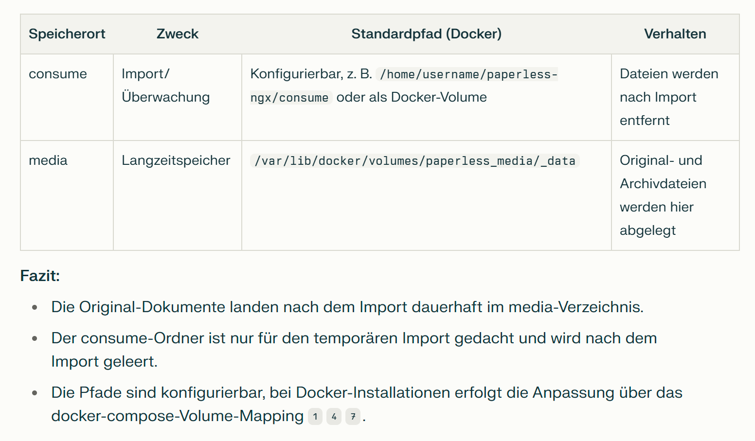

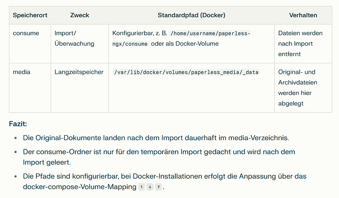

In Stack kann es doch gleich „umgeleitet“ werden
    volumes:
      - /home/shares/pi/500gb-sdb1/Paperless/data:/usr/src/paperless/data
      - /home/shares/pi/500gb-sdb1/Paperless/media:/usr/src/paperless/media
      - /home/shares/pi/500gb-sdb1/Paperless/paperless-outbox:/usr/src/paperless/export
      - /home/shares/pi/500gb-sdb1/Paperless/paperless-inbox:/usr/src/paperless/consume
