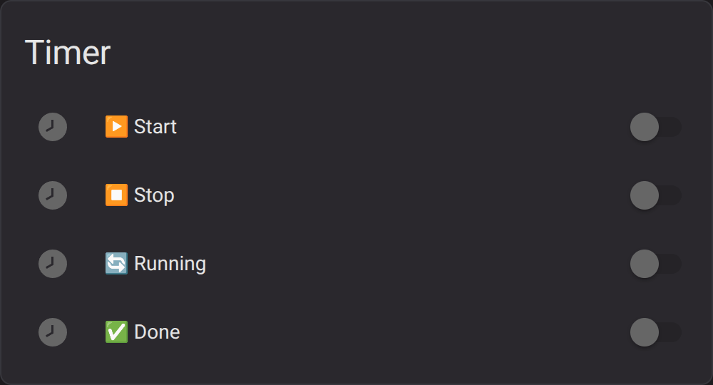

input_boolean.teich_timer_start
input_boolean.teich_timer_stop
input_boolean.teich_timer_running
input_boolean.teich_timer_done
dadurch kann man den Blueprint mehrfach verwenden
Dann Zuordnung im Blueprint:
Start Trigger → :point_right: input_boolean.teich_timer_start
Stop Trigger → :point_right: input_boolean.teich_timer_stop
Running → :point_right: input_boolean.teich_timer_running
Done → :point_right: input_boolean.teich_timer_done
Dauer → :point_right: “05:00:00”

:movie_camera: Demo
Demo
