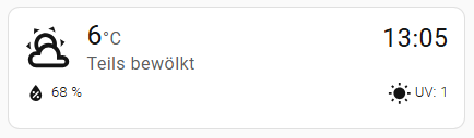

type: custom:simple-weather-card
entity: weather.DeinWetterSensor
backdrop:
  day: var(--primary-color)
  night: "#40445a"
primary_info:
  - humidity
secondary_info:
  - wind_speed
  - precipitation
  - precipitation_probability
tap_action:
  action: navigate
  navigation_path: "#Wetter"
das ist mein code, ich bekomme bei primary info neben der Luftfeuchtigkeit nicht die Temperatur (höchste und niedrigste am Tag) rein
der rest funktioniert

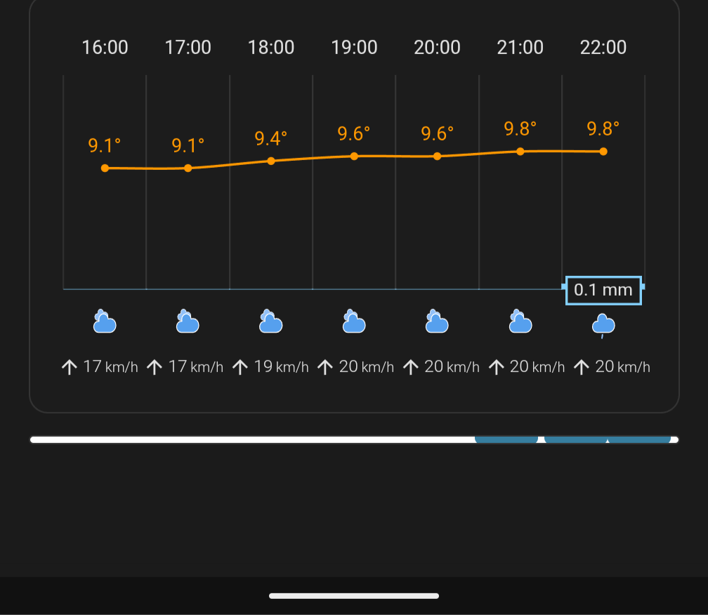

Kannst ja auch die weather-chart-card ein wenig eindampfen.
type: custom:weather-chart-card
entity: weather.wetter
show_main: true
show_temperature: true
show_current_condition: true
show_attributes: true
show_time: true
show_time_seconds: false
show_day: false
show_date: false
show_humidity: true
show_pressure: false
show_wind_direction: false
show_wind_speed: false
show_sun: false
show_feels_like: false
show_dew_point: false
show_wind_gust_speed: false
show_visibility: false
show_last_changed: false
use_12hour_format: false
icons_size: 25
animated_icons: false
icon_style: style1
autoscroll: false
forecast:
  chart_height: 1
  precipitation_type: rainfall
  show_probability: false
  labels_font_size: "2"
  precip_bar_size: "100"
  style: style1
  show_wind_forecast: false
  condition_icons: false
  round_temp: false
  type: daily
  number_of_forecasts: 1
  disable_animation: false
units:
  speed: ""
